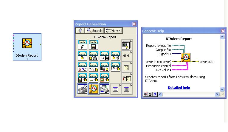

Hello Parag_M,
A simple and quick way to use DIAdem option's in LabVIEW is to use the following express VI....
Cheers!
Jayanth
