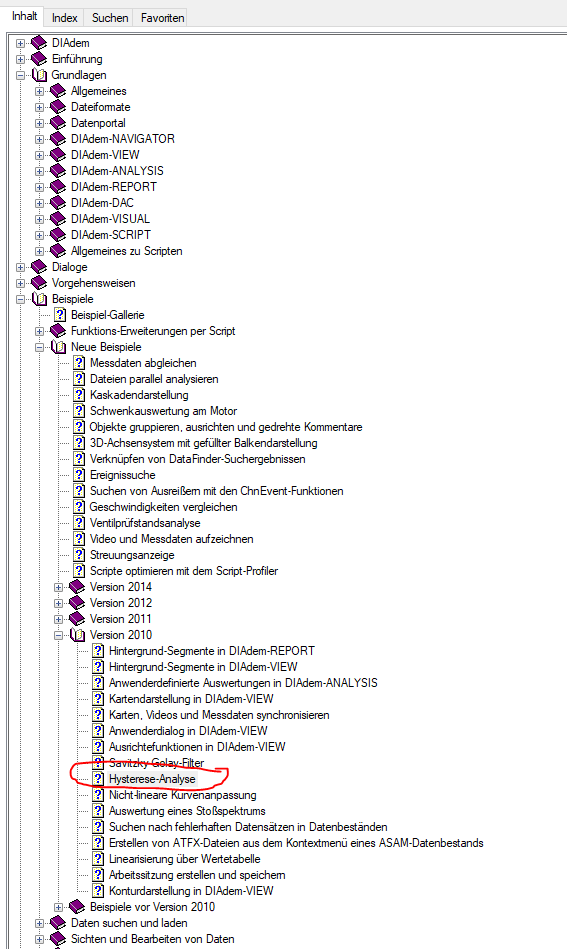

Hey,
try to find the example direct in Diadem.
Press F1 (doesn't matter which module) opens the help window.
Then go to Content -> Examples -> Version 2010.
At least in my 2015 - Version it's there.
Greetings,
Vassili
(2,285 Views)
Hi, Thank You very much for response. I found and adapted to my file.
