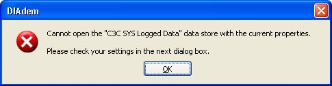

In the Advanced section, I have the timeout set to 90 s. When I hit OK, I then get the following message, which then takes me back to the previous screen.
Error message

Thanks for replying. I had a thought that maybe my Windows firewall was the problem and that turned out to be true. As in I turned it off and suddenly I could see data.
