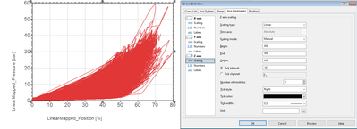

I'm trying to plot two channels against each other and for the below example I have Pressure vs Position. This data trace is over an hour long and I would like to be able to see the change in the plot over time. What I have done in the past is manually copy the channels and remove the extra data and plot that stripped down data. Then I could get the first and last 5% of the data with a couple extra chunks in the middle. I'm hoping there is a graph setting that I am missing to easily zoom in on certain time ranges since there might be dozens of sections I would like to inspect closer.

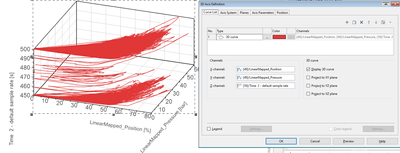

The closest I have gotten in REPORT is the 3D Curve. I can set the z-axis (time) to 450-500 seconds and I can see the pressure applications, but it still shows all of the other data below 450 and above 500 seconds. Ideally I want to be able to change the z-axis and limit what data is shown so that I can just view that snippet of data on the XY plot (Pressure vs Position).
All data is still shown in the XY view, even when I limit the z-axis unfortunately.

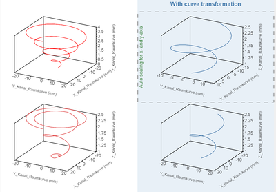

The layout I have prepared shows the complete curve at the top left.
At the bottom left, the 3D axis system is provided with a manual scaling of the Z-axis (1.0 - 2.5). => Bug
At the bottom right is the 3D axis system with the curve transformation, which has manually scaled axes to show the section of the curve.
At the top right, the curve transformation is also used, whereby the Z-axis is scaled manually and the other axes are scaled automatically.
