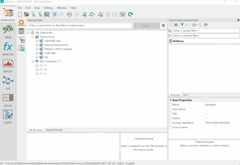

To solve your job you can think about using DIAdem Datafinder to do it and load the search result as channels.
