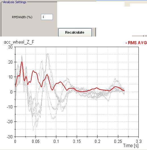

The data are signal of sensors of vehicle comfort. I have a Chn_Time and signal of the sensor vehicle. I attached a picture.
As you can see you can change the % os RMS width and the button Recalculate call function ChnRMS(...) like I explain in first post.
This function ChnRMS change it the AVG RMS channel (color red in the graph).
But the users that use my script want that the value is indicated in milliseconds and not in percentatge.
I don't know about the way to do it.

BradI create the chn time to calculate the RMS with this function:
Ini_F = 0.015
End_F = 0.25
SampleRate_=2500
    Call ChnLinGen("Time_Front", 0, (Ini_F+End_F), (Ini_F+End_F)*SampleRate_+1)
I use this channel time.
What is the way to sampling period? what is the way to recalculate Rms with milliseconds?

You can convert the known time window in seconds to the required window in % with the following equation:
L1 = CNo("Time_Front")
Percent = (CMax(L1) - CMin(L1))*SampleRate_/100
It would also be possible to create a custom dialog that does this automatically and have your user pop up this dialog instead of the ANALYSIS RMS dialog, but there is no way to customize the appearance or behavior of a shipping ANALYSIS function.  We coudl hijack the ANALYSIS icon for the RMS calculation and have that call up your custom dialog, though.
