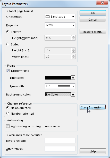

Go to the Settings menu in "REPORT" and switch on the "Curve Expansion" mode:
I have thre Waveforms loaded called "Noise", Noise1" and "Noise2" in my DataPortal
In your Axis Layout, delete the group reference and add a "*" to the end of the channel name:
Here is the result, which will dynamically add channels based on how many "Noise*" channels are in the DataPortal:
