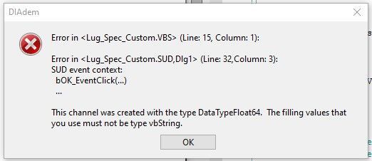

I am trying to make a dialog window where a user can enter engine speeds and those values will be transferred to a newly created numeric channel.  This is working to get the table values to an array, but if I try to assign the values to oSpeedChannel I get an error that these values can not be assigned due to the DataType Float 64 of the channel I created.

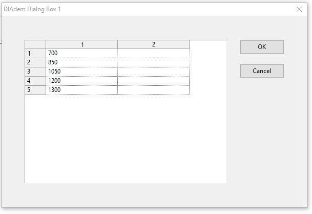

Here is what my table looks like
When I click ok It creates the channel, but errors out at the line for oSpeedChannel.Values(i) = Table1.Cells(i,1).Value
Is there a different way to read in table values from a dialog window that I can import into a numeric channel?

Hi OKCat2015,
You can use the Val() function of DIAdem to convert the text values into double values.
It would work like this:
oSpeedChannel.Values(i) = Val(Table1.Cells(i,1).Value)
