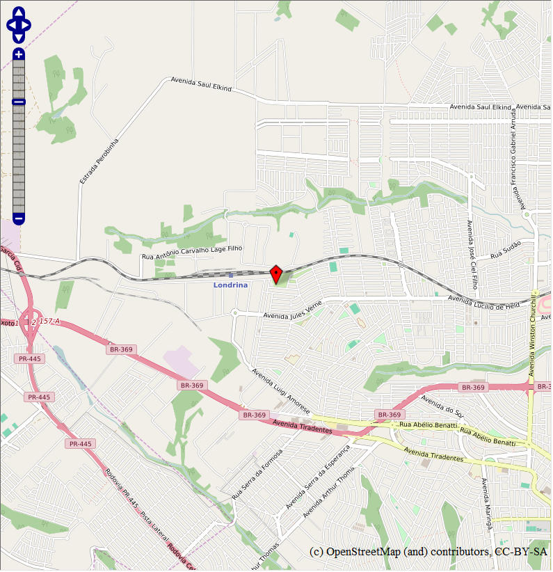

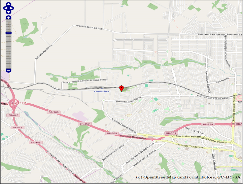

I am trying to transfer a map from the VIEW panel to the REPORT panel. However, it doesn't matter the way I do it (by button or by script), the map gets strechted. Do you guys know how to fix it?
VIEW Image
REPORT Image

We found out how to solve the problem described in this post. In case someone is having a similar problem, try to right-click on mouse in the map that you transfered to your REPORT panel. Then, select the option display. After, click on position and mark "Keep aspect ratio". That's all.
