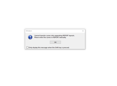

Hello, I currently have DIAdem 2015 SP2, when I try to transfer any data from the view tab to the report tab I receive the following error.
"Cannot transfer curves into expanding REPORT layouts. Please enter the curves in REPORT manually." Any advice or possible solution would be greatly appreciated.

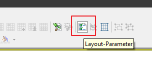

Hi Mitchel,

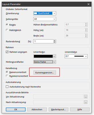

If you open the Layout Parameter dialog in REPORT,

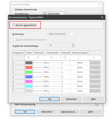

And then the Curve Expansion Mode sub dialog,
And switch off the Expand Curves mode
You will be able to use the transfer function in VIEW without problem.
