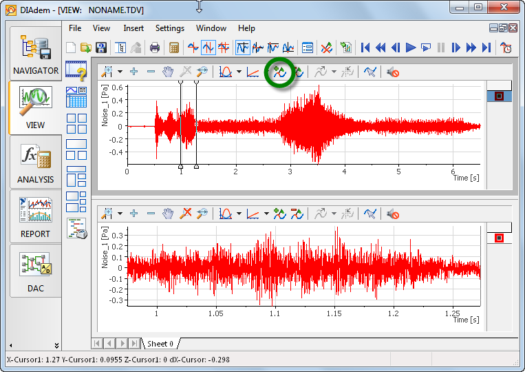

  1. Put you data into the VIEW window. Then pick the BAND cursor in the toolbar (see below)
  2. Select the "Set Flags" icon in the VIEW windows with the data and the Band Cursor:
  3. After you have the data selected with the FLAGS (the data points will be displayed in a thicker line style) click on the "Copy Data Points" icon:
  4. You will get a full copy of the data in the band, copied to a  new channel in the Data Portal. In the example below I dragged the new data into both windows (not that the red data is still highlited by the flags, this it's a thicker line style).
