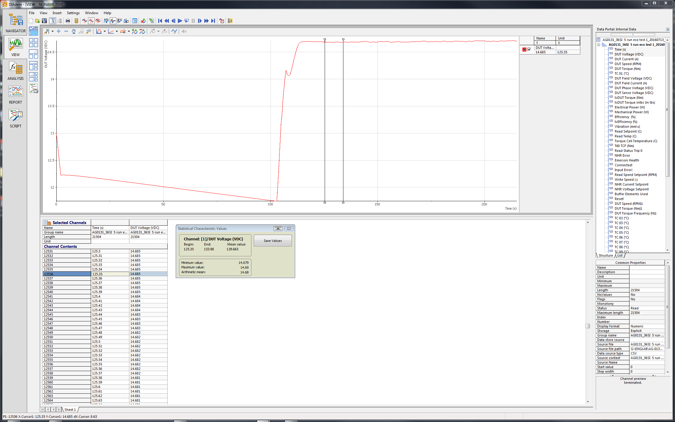

Brad,
I wanted to follow up with you. That works great. Thanks for the suggestion. diadem cursor stats.PNG
Damian

Thank you for your help. I post this to save others time in finding the script.
@ Damian_S: Your screenshot isn't helping - I don't get what you want to show (except success) 🙂
