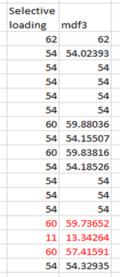

I wanted to kindly ask if it is possible to load a .dat file using the mdf3 dataplugin but stoping the interpolation process that it automatically does, instead of the linear interpolation I just want it to keep original values from the raw file...
I have tried different ways for example: when I open selectivly it gives me the original channels but it lose some values (size = 3426)... when i load the complete file it performs the interpolation (not desired) bt gives me the complete channels (size 3443). Any ideas???

I don't know of any file-based DataPlugins that automatically perform interpolation while loading data values.  Could you post or email that data file which has the values you posted?

There was an axisting UserCommand the one creating the problem. Not the dataplugin as you said.
