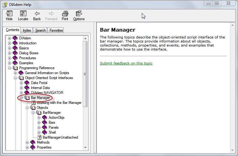

Hello Rsh,
What you are looking for is the BarManager object (don't let anyone say that the DIAdem R&D team has no sense or humor, they picked that name).
The BarManager object is used to access and manipulate the icons in the panels, and bars of DIAdem.
You should check out the help system here:
and the examples here, especially the second one called "Adding User-Defined Functions to the Group Bar".
The bar manager will allow you to add your own icons to anywhere in the panel bar, group bar, function group or tool bar shown in the screenshot below:
I hope that will get you on the right path ...
