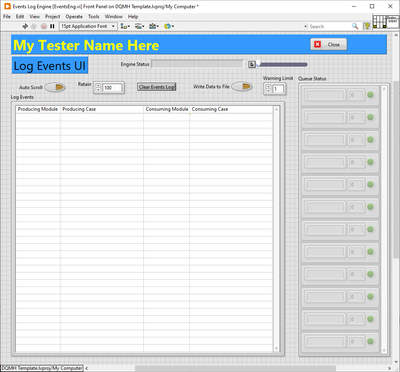

I would also like to see some sort of program flow module that the developer or the user can view during run time that TiTou was commenting on. I created one for a simpler QMH that showed in a spreadsheet form, the events produced by the producing module+case and the events consumed by the consuming module+case. It also showed how many queues are on the stack for each module. This was very useful for troubleshooting the code for new developers inheriting the code. A developer or user could clear the log, press a button and watch program flow. The module also had an option to save this data to an Excel file. Below is a front panel view of the module.
I'm new to DQMH and would like to say "What a cool tool" and hopefully I'm not missing something.

Dwackerbarth,
Have you tried right-click on an event structure and using the event inspector while the program is running?
