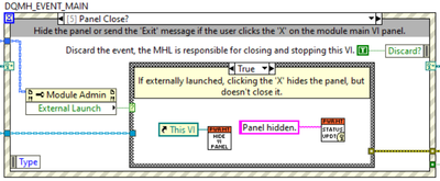

"Panel close?" event in External Launch should broadcast a "Panel hidden." Status update
Status: Released
Just a very, very simple proposal for consistency, as per what the title says: when a "Panel close?" event is triggered in "External Launch" mode, the module should probably broadcast a "Panel hidden." Status updated. Like this:
Do you agree or is there any reason I'm missing for which the broadcast was not placed there?
Thanks!

Status changed to: New
No particular reason why it was not there and I agree that it would provide consistency.
Thanks for the suggestion.

Status changed to: Released
