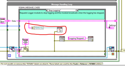

Command start creates a TDMS file in Logger.vi in the "Initialize File" case. Stop logging function stops the measurement and logging. If I do not close this CML UI module but start logging again, this creates a new TDMS file and the first TDMS file stays open until I close the CML UI module. After that, both files are properly closed and no data is lost.
My questions are where is the data from the first start saved? Do I have to close the CML UI file after each measurement in order to close the TDMS file?

Does anyone use the project CML Delacor? There is a solution to my question yesterday: another Close file.vi comes in the Logging module in the case "Stop Logging". Now the command "Stop Logging" also closes the TDMS file and the module CML UI continues to run on repeated measurement. At each new measurement the measurement data come into individual TDMS files without closing the module CML UI. See the picture below.
