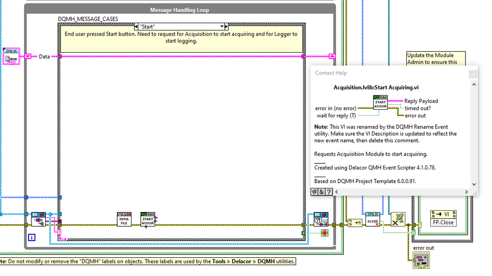

this may be obvious but I am not sure if I understand the code correctly:
Are there any "Request and wait for reply" events used in the "DQMH CML" template (the one shipped with the DQMH installation from VIM)? If so, how can I identify those?
As far as I understand it, there are only "Requests" and "Broadcasts" being used, especially the acquired data is not a payload from a "Request and wait for replay" but a payload in a broadcast. Is that correct?
Thank you for helping me get a better understanding of the code.
Martin

Oh well, I should've researched a little bit more before posting here 😋
I found a good documentation on the whole thing here:
https://wovalab.gitlab.io/open-source/labview-doc-generator/doc/Antidoc-Output-v1.0/Project-Document...
And the VIs "Acquisition.lvlib:Start Acquiring.vi" and "Logger.lvlib:Start Logging.vi" (in CML Main.vi under MHL case "Start") both have a "Reply payload" output, so this should have been obvious to me.
(1,927 Views)
