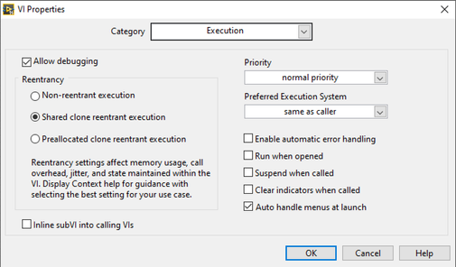

In DQMH 6.1, the default setting for a "Request and wait for reply" VI of a cloneable module should be "Shared clone reentrant execution", as shown here:
I can totally see how you would experience jitter if your request VI is actually set to non-reentrant execution. Please use the DQMH Module Validator to check if any VIs in your module are set to non-reentrant and fix those.
I'd be surprised if you still saw jitter after making these fixes, and - same as Darren - I'd be also surprised if switching from "Shared clone reentrant" to "Preallocated clone reentrant" made any noticeable difference.
