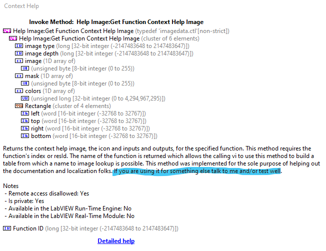

I found this :
I don't know who "me" is...

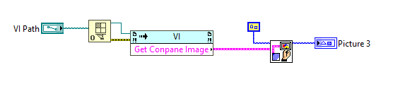

While trying to use the method above, I found this easy way to get the icon + inputs / ouputs
