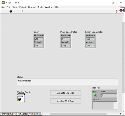

Too add to my post from yesterday...I've looked into this some more and I'm still stumped.

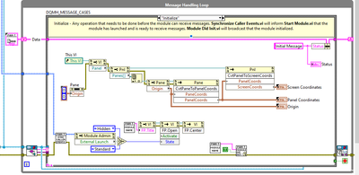

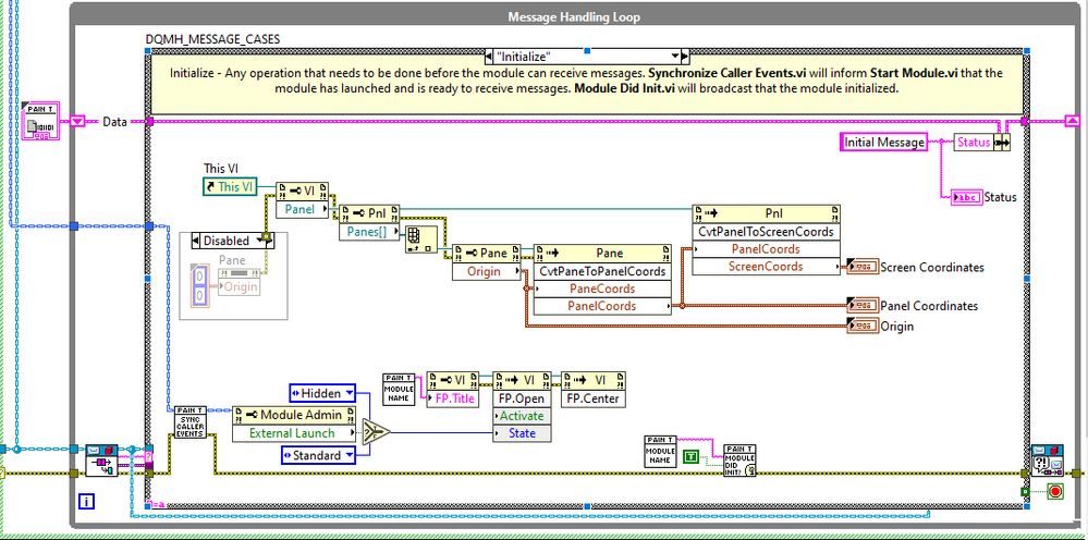

I found this post last night -> Christina_R post about Screen Position from 2012 which provided some clarity on the Pane vs. Panel vs. Screen coords and how they relate but I'm still seeing a discrepancy in the DQMH front panel.  I modified the BD slightly so that the Pane isn't set to 0,0 (top left corner of the panel) so that I can scroll it on purpose to see the values, and I also added an indicator for the Screen Coords (not going to re-post the VI).

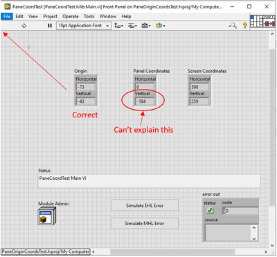

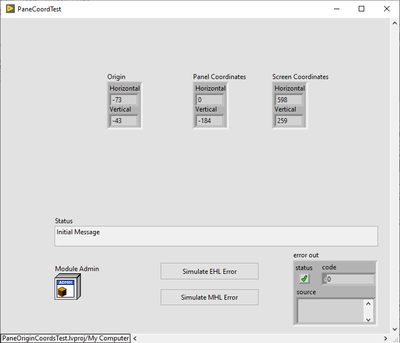

I've tried running it with and without the Menus and Toolbars options (in VI Properties) and both show a negative value for the Panel Vertical component, however, the Menu and Toolbar heights are included in the Vertical value when they're included (but they're still negative).  It's almost like there is a fixed offset in the Vertical component.  I do not experience this issue on a Non DQMH front panel VI.  Is there a setting that I'm not aware of that's built into the module? Or is there a scripting function that's playing with the Panel coords?  The weird thing is that the Screen Coords seem to be correct or aren't out to lunch at least.
Edit Time - No Menu or Toolbar in VI PropertiesEdit Time - No Menu or Toolbar in VI Properties
Run-Time - No Menu or Toolbar in VI PropertiesRun-Time - No Menu or Toolbar in VI Properties
Run-Time - with Menu and Toolbar in VI PropertiesRun-Time - with Menu and Toolbar in VI Properties
I'd like to be able to use Panel Coords to place certain controls and indicators and also to help with some custom scaling, but I can't do that with the current situation.

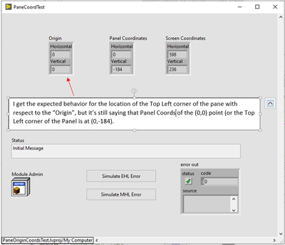

Hi Fab,
I get the expected results for the top left corner of the panel with respect to the "Origin" of the pane, but it's still saying that the Panel Coords are (0, -184). I'm only using one pane here for simplicity but in my other UI with 3 or 4 panes (also a DQMH module Front Panel) all of my vertical coords are negative.
Origin enabledOrigin enabled    ResultsResults
I don't see this behavior if I just create a VI on it's own (i.e. not a DQMH main.vi front panel).  I don't know if there's actually a correlation or if I just have a setting wrong.

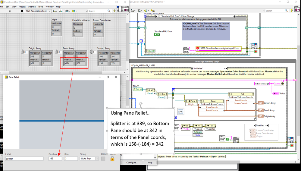

Just for kicks, I threw a splitter bar on that FP and opened up the Pane Relief toolkit to check the splitter position.  It is correct if you subtract the vertical components of the Panes in terms of Panel Coords so there seems to be an offset for some reason (see image).  I just tried doing this in another DQMH main.vi front panel and the Panel coords for the "origin" of the Panes are much larger (on the order of -1500 to 1800) so the offset is a mystery to me.
Two PanesTwo Panes
Sorry for all of the images.  I can upload another .zip file with the actual VIs if that will help.
