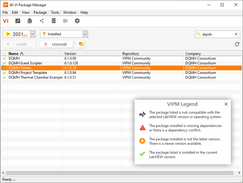

Did the DQMH Palette 6.1 get installed? Make sure you don't still have the DQMH 6.0 palette, which would definitely cause the problem you're seeing:
Assuming you do have the DQMH 6.1 palette installed, can you reply with a screenshot of the Start Module.vi diagram for your DQMH 6.0 module? In particular I'd like to see any 'Module Admin' or 'Mod Admin' property nodes.

My DQMH version numbers are all the same as in your screenshot.

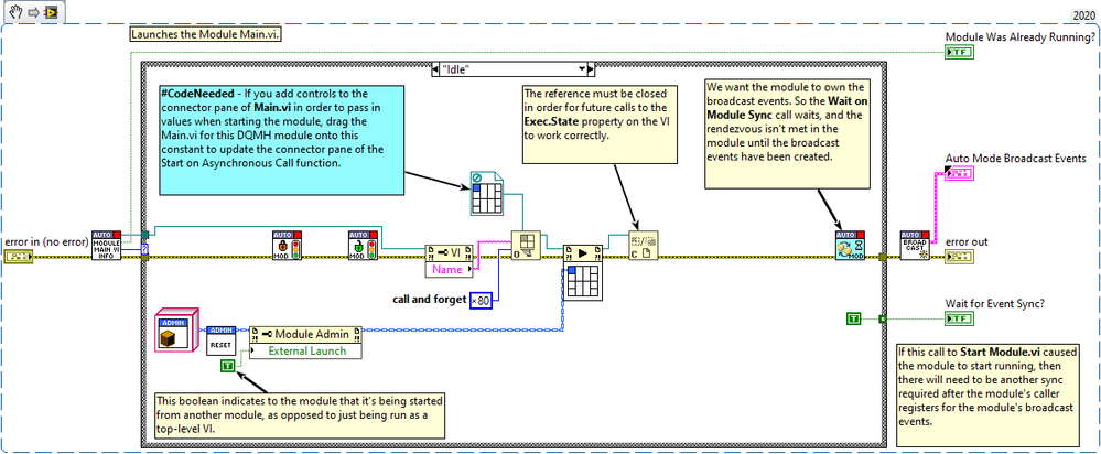

Here is my "start module.vi" from one of the (already updated) DQMH 6.0 modules:
start module.vistart module.vi

(2,343 Views)

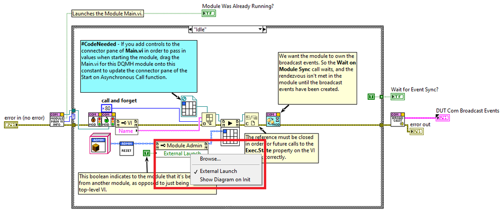

I was able to run the validate tool on your module without error, so something looks to be messed up on your machine. Can you open the DUT Com.lvlib:Start Module.vi and click on the Module Admin property node and screenshot the drop-down? On a normal system it looks like this:
