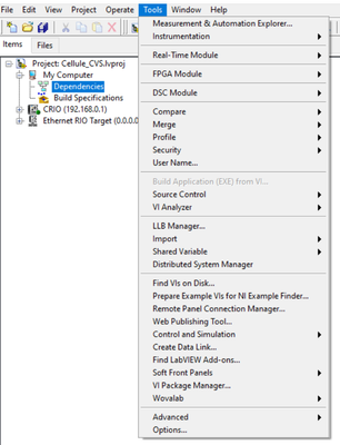

Hello ,
I just installed the DQMH toolkit v6.0.0.83.
The problem that on labVIEW , the Delacor menu does not appear in tools .
I tried uninstalling and reinstalling DQMH but that didn't fix the issue.
Anyone have a solution , please ?
Thank you

In the picture, you are showing it installed for 2019 32 bit.  Is the picture of the Tools menu also in LabVIEW 2019 32 bit, or is it another version.  Make sure in VIPM that you have installed it for all versions of LabVIEW you have installed.
Also, did it also install the DQMH dependencies?
