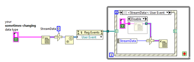

One additional suggestion for you, in case the data type you stream changes over time, you can typecast the DVR ref into a U32 to make it "embedded-data-type agnostic".
If you do that, when you typecast back from U32 to DVR ref, place the "create DVR" primitive in a disable struct and the data type out of the disable struct 😉
Putting the DVR in a Variant is a safer way to do this, in that you wont crash the program if you cast to the wrong datatype (you'll get an error instead).

...and I was wrong to think that the to-variant + variant-to-data would take longer to execute, it's the same!
I hope LabVIEW will find other ways to crash 😮
