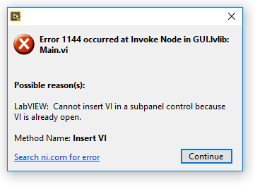

For a new application which I am building I am using DQMH as my architecture. I used more or less the same setup as given in the CML DQMH sample project (so a launcher which launches my main GUI which in its turn launches my modules). Some of the modules I use the UI as configuration and display panels. For testing I defaulted first to just show and hide the panels when needed. However, now I want to add a subpanel control to the main GUI and load the front panels of those modules in there. So, at first, I obtained a reference to the main of the module with VI Server. When I use this reference, I get the following error:
I also tried it by bringing the VI reference which is obtained within the Start Module VI outside and use that, but it results in the same error. Has anyone who tried subpanels in DQMH seen this issue before. I do not see what I am doing different from the example project for subpanels.

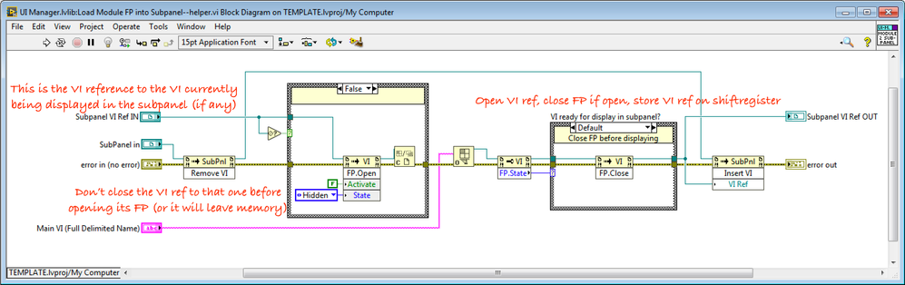

With the problem being that the FP is already open, we work around that by closing it first, then inserting. You need to keep the reference to the VI open so it doesn't leave the memory when you close the FP.
You can find our implementation here:
https://gitlab.com/hampel-soft/dqmh/hse-application-template/blob/master/TEMPLATE_Source/Framework/U...
While taking the screenshot, I realized that it could with a little more documentation...

Thanks Joerg,
That was the issue. I already thought it had to be something like that!
