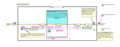

Actually I am calling sub module from main module. I wanted to stop sub module and start it again from main module. When I am stopping sub module using stop module.vi of sub module, my main module goes to hidden state. Is their way to stop sub module without main module go to hidden

I am using LabVIEW 2020 SP1 32-bit and DQMH 6. I modified start module so that I can call sub module front panel through subpanel reference.

Have you tried to generate a project from the template "DQMH" provided when you install the framework? It demonstrates how to start and stop modules. Even if the start is made from a simple VI it should work the same from a module.
I also want to point out that the screenshot you posted is not the latest Start Module implementation (not the one you should get from a new module created with DQMH 6.0 at least). You run Validate module tool to see if things are ok with your modules.

 The screenshot I posted is not the latest Start Module implementation. I changed it because I want to use subpanel ref and it is working fine, only issue I am facing  is when I am stopping sub module using stop module.vi of sub module, my main module goes to hidden state.

@Roshan777  a écrit :
Hi Olivier,
I think I get your issue. I'm just saying that before going further, you need to update your start module with the validate module tool because lots of things changed in this part of the framework. You can totally update your code after that to use the subpanel. If your issue is still happening, we won't doubt that it could be due to this outdated Start Module function.
