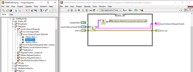

I believe I have found a memory leak with Private Events in Cloneable (and possibly standard) Modules.
In the "Obtain SEQ.vi" that is called by the "Obtain Request Events.vi" the VI obtains a reference to a named queue that is not cleared out by the immediate call to the "Read SEQ.vi".
When the obtain queue function is called with a named queue "the function searches for an existing queue with the same name and returns a new reference to the existing queue". This is stated in the documentation for the "Obtain Queue Function". https://www.ni.com/docs/en-US/bundle/labview-api-ref/page/functions/obtain-queue.html
This reference should be cleared by the "Read SEQ.vi" that is called immediately after the "Obtain SEQ.vi". See below screenshot for my temporary fix to test my suspicion.
This clears the memory and prevents the leak in my testing.

Bug #931 has been fixed in DQMH 7.1. We do have a beta release of 7.1 available, so if you're willing to take it for a test drive, please reach out to us.
If anyone needs a fix sooner, all you have to do is manually add the "Release Queue" function to your code in "Read SEQ.vi" as shown in the screenshot below.
