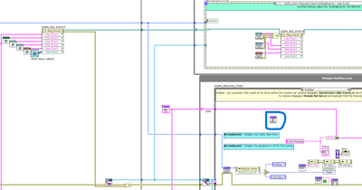

Ok, so I created a private request and placed the code as you have it in the EHL.  Where should this request be called in the INITIALIZE case?  is there a certain timing it has to be done at?
I've put it after Synch Caller Events and before Module Did Init and appears to be working correctly.

The VI surrounded by the blue circle is floating arround with nothing to enforce when it is supposed to execute.
If you want it to execute after the Synchronize Events and the Module Did Init, then you could wire some error wires in between the Synchronize Events, your Private Request VI to Register for Events, and the Module Did Init Broadcast.

Yes, sorry, used the wrong screenshot.  I did wire it in
I suppose the question is should that be after the Synch caller events or before?  is it in the right place?
Message 18 of 22
(1,735 Views)
Nothing should be wired before the Sync events. So it is in the right place now.

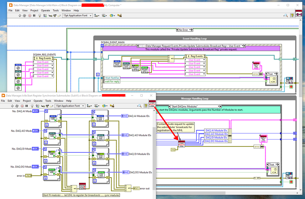

Jörg, I'm attempting to be more controlled when starting my child modules and have taken your recommendation from the fantastic post here to start the modules in the MHL. In your example you used 1 private request with reply to update the submodules' broadcast for registration before synchronizing the events. In my case I would like to start N submodules in the MHL and register for broadcasts in the EHL.
Without having to make more private requests, what would be a good way to start N modules, register for broadcasts in the MHL and then synchronize N modules?
What I came up with is having the Start module Public API in a For loop, execute N times, and the same thing for the Sync Mod Events.vi, following the reply from the EHL.
I think it is working but wanted to ask here if there's something I'm overlooking with how the DQMH modules start and are synchronized.
