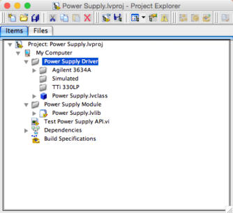

step 5:
    Chris shows the cloneable DQMH module and the Power supply class hierarchy:

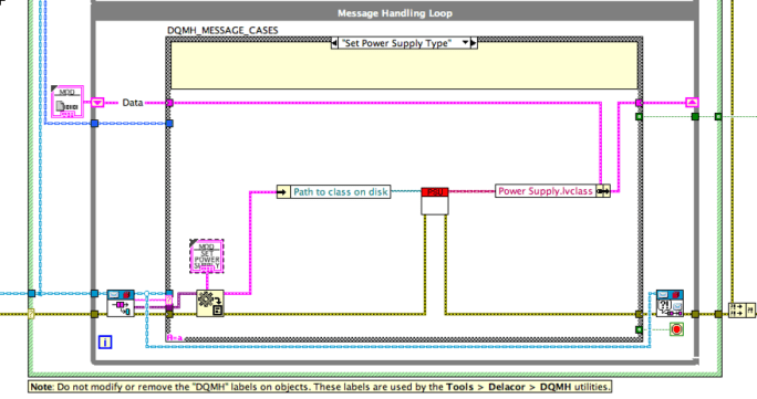

On step 6
    Chris shows the creation of the events and how the local data in the cloneable DQMH module holds the actual Power Supply instance based on the class path chosen via the "Set Power Supply Type" Request.
