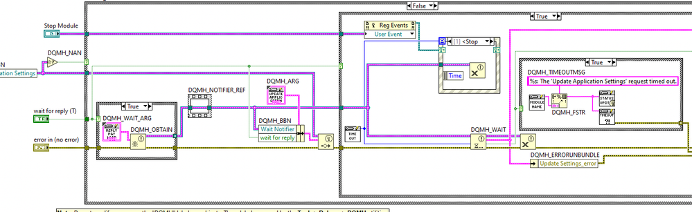

Anyway, I would try to implement #5 of the document like this. Code is crapy, but the idea is to destroy the notifier if you receive the stop module event of the module calling the request.
To be tested, obviously.

You're right, Chris. I read them the #5 too fast. You obviously need to handle the thing in the MHL that actually handles the request if you want the module to stop.
In my solution, I handle one part of the rare corner case where you would like to stop a module that waits for a reply that takes a long time to respond without stoping the module that handles the event. It could happen when you clone a module to address a specific task for a limited amount of time on a particular occasion.
As I said, I didn't come across this kind of use case so far, and it's a thing to think about for more than 5 minutes.
If I go back to the original question, I would probably try to implement the same kind of mechanism to know if a stop module has been sent and try to stop the code before completion in the MHL case that handles the request.
