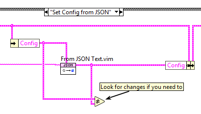

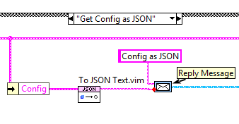

@AlexElb wrote:
Let us stay in the DQMH world. So we have our Module Data Type Def in the shift register of the MHL. I expect you hold your configuration data inside there too, don't you? In a big Cluster, in a Class, how?
Do you have read/writeSettingXyFromModuleData.vi with a TypeDef to use the setting inside the module?
There is a variety of options, but I often have a (non-type-def) cluster in a shift register called "Config" that holds the config info.  Then I just convert to/from JSON using standard JSONtext functions.   Example:
If I have Objects to save, then I need to have Get/Set JSON methods to do that, but internally these just use JSONtext subVIs in a similar way.  Then that JSON is combined with other config JSON, again using simple JSONtext functions.
