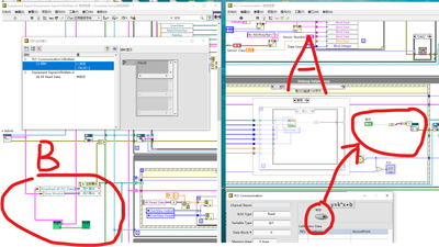

hello,everyone!I am newer to DQMH,Some issue  bothered me for many days about broadcast event,please help me
The first is,I have A module and B module,I added a helper loop in module B to receive broadcast data。Module A broadcasts the cluster array. Module B registers to broadcast, but the broadcast events received by module B will be delayed by 10 seconds。 Just like  I click the Boolean button in Module A, module B will  receive data after about 10 seconds.
Second,I use private request in MHL to update the parameters of helper loop. It always delays or does not happen, so I use local variables to update data
This situation gets worse when I insert module B into the sub panel of module C (UI)
thanks a lot!!!

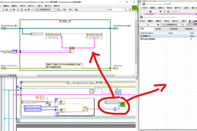

In module B, I used the replace array subset of multicolumnlistbox by Qcontrol

I have verified it through the three ways you said. I think I already know the answer. That is, I should not use the for loop in broadcast events. If the for loop is disabled, everything will return to normal
But I have to read the data through a loop, because the number and value of my array index elements are variable
At present, I use request and wait for reply in the timeout of module B instead of broadcasting to obtain data
Or do I still use broadcast events? Is there any other way to meet my needs
thanks again
