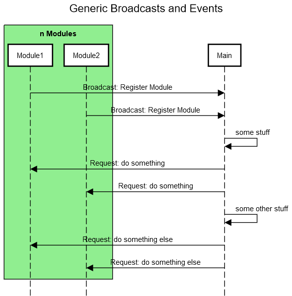

I didn't come up with a solution, so may be you have some clever ways for the following problem. Lets say we have n modules which all should implement a few common methods, which should be triggered by another module. How do you solve that?
My thought is, that they register themselves with a generic Broadcast Event and the other module "Main" stores some references in an array. Then it can call dynamically the methods of the modules by using the references of the requests...
So, can I implement the Requests "do something" and "do something else" and just copy the refnum out of the Obtain Request Events.vi and pass those as the Broadcast data? When adding modules, I don't want to manually add Requests.vis to "Main".
And how would I register for the generic "Register Module" Broadcast Event? In "Main" I don't want to start Module1 and Module2. Also I only want only one generic EHL-Case for all n modules.

Consider having a "n Modules Manager" module sitting above n Modules, to be your "single EHL" that looks after n Modules, and also launches the n Modules.
One thing I've observed from recent projects is that if we make a module a cloneable, then there still needs to a management layer sitting above it to handle the fact that we have more than one clone doing things, and the application needs to know about how to use these cloneables properly (whether that is in the form of another module, or just a bunch of Sub-VIs in the application).

Maybe you can draw some inspiration from how we start and register modules (and call their API dynamically) in our application template: https://gitlab.com/hampel-soft/dqmh/hse-application-template

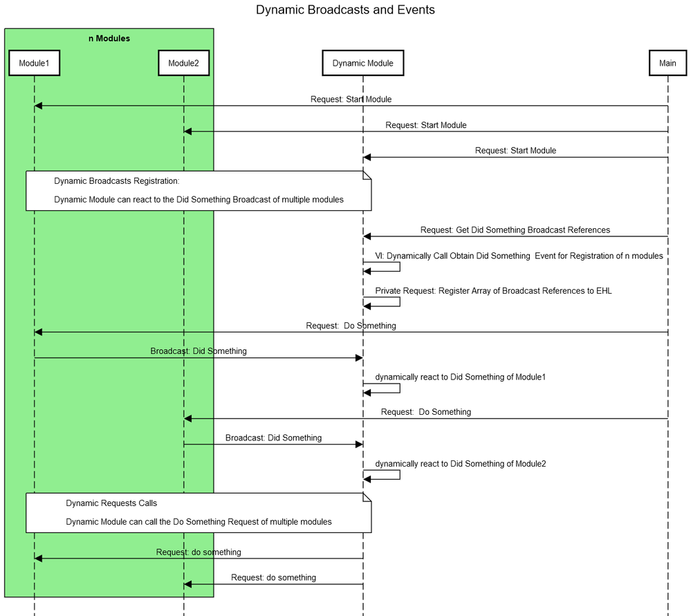

While writing this post I've learned a lot. So I'll try to sum it up in general and start with the easier case:
One module wants to call dynamically the same Requests to multiple DQMHs.
  • Request Events must have the same connector panes to be called by reference dynamically
  • That can be achieved by a) encapsulating, if no or the same data input or output is neede or b) using a variant
  • Now we have implemented a "Do Something Request.vi" in multiple DQMHs
  • Implement a VI "Dynamically Call Do Something Request.vi" which takes a reference to the application and a path to module as Input. There build the path to the "Do Something Request.vi" and call it by reference
  • In the DQMH which should call the Requests we need to know the modules path information and call the VI "Dynamically Call.."
Now to the case where a DQMH should dynamically register to multiple Broadcast Events:
  • Again: The Broadcast Events "Did Something" all must have the same connector panes
  • Implement a "Obtain Did Something Event for Registration.vi" in the multiple modules and wire out the needed reference
  • Implement a "Dynamically Call Obtain Did Something Event for Registration.vi" which takes a reference to the application and a path to module as Input. There build the path to the "Obtain Did Something Event for Registration.vi" and call it by reference, wire out the needed reference
  • In DQMH which should register for that Broadcasts:
  • Create Request Event: "Register for Did Something Event" with an array of the Broadcast reference as argument and move it to the Private folder
  • We need to know the modules path information and call the VI "Dynamically Obtain..." (in a loop thats why we need an array of references)
  • Bundle a constant of the "Did Something" Eventreferences (as an array) to the DQMH_REG_EVENTS User Event
  • Send the array of the Broadcast references to the EHL using the newly created private Request and register them to the EHL
  • we can now create a new EHL-case "Did Something User Event"
 Updated Sequence DiagramUpdated Sequence Diagram
Please correct me, if I've missed some important points
When creating the user event referencesand the VI references, do I have to consider something? Can I just create them in one Module and use the for the other too? Unless they are not stricty type def...?
What is the difference between dynamic and generic? What should be in my mind when designing a solution?
I think what I am doing in this diagram is only dynamic: At edit time the Dynamic Module doesn't know which Modules it will call and to which Modules it will react. Though having a Dynamically Call Obtain Did Something Event for Registration.vi is very specific. So Dynamic Module doesn't know which modules, but it knows exactly which Events are involved. Is this good or bad?
Are you doing something more generic with your System Message in the template?
Thanks Christopher for your hints concerning the cloneables. Until now I was speaking about multiple Singletons. That problem will probably come later to my mind, when I'll start using clonables.

Blimey, that is one elaborate answer / write-up! I'll ditch our documentation and just link to your post 😉
Regarding the template application: The TEMPLATE_Source/startup.vi reads the list of modules to load from TEMPLATE_Config/config.ini. It starts the User Manager (the module comprising the UI frame of the application) and the Event Manager (used for debugging mainly), starts all the modules as defined in the config file, then hands over the list of modules to UI Manager and Event Manager. And then some more stuff.
More information is available in our Dokuwiki:
https://dokuwiki.hampel-soft.com/code/dqmh/hse-flavour
https://dokuwiki.hampel-soft.com/code/dqmh/hse-application-template
Coming back to your questions: For creating the references, I made sure to have dedicated template VIs and typedefs in a shared library to avoid any unwanted dependencies.
Dynamic in this case to me means "not static", as in no static dependencies. Not so much "not knowing who to call at develop time". That rather falls into the category of "generic", meaning to me "not catering to a specific situation", i.e. a high level of reusability.
And yes, "System Message" itself is generic. We use it both generically (eg forwarding networked messages without knowing about sender, receiver or content) and specifically (eg for communicating specific commands to the UI Manager).
