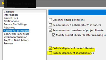

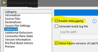

Debugging: (depending on what you want to do)
Exclude dependent packed libraries: (Always enabled!)
Exclude dependent shared libraries: (Always disabled!)

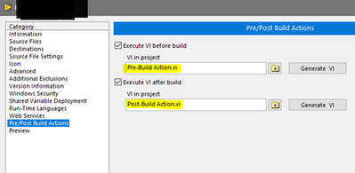

Use Pre-/Post Build Actions to optimize your build
  • Remove all Breakpoints before you build
  • Check for misssing Items.
  • set conditional disabled symbols

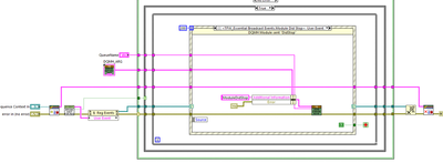

Call (non PPL) DQMH from PPL DQMH modules
  • The GUI is available as source code and will be compiled later as EXE
  • The GUI DQMH modules are not used as a PPL
  • The Module1 uses requests from the GUI / delivers data with broadcasts

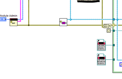

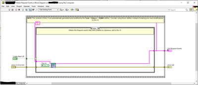

Obtain Request Events.vi
For all GUI-DQMH modules "Obtain Broadcast Events.vi and Obtain Request Events.vi) must be extended. The VI searches via "VI server" the instance with the valid UserEvent registrations).

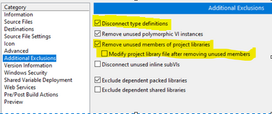

Main Application settings
If you receive "Error 1003 occurred at File XXX.lvlib:Start Module.vi" you can try the following setting:
  • I do not recommend "Disconnect type definitions" for PPL's", but for application its worth a try! 😉
The picture is not clear enough.Could u show me where  i can find the vi(the valid UserEvent registrations)?
Thanks!
(5,286 Views)
These VIs are only needed if you mix PPL and non-PPL event/broadcast registrations of the same library.
1) Insert the Helper_BroadAndRequest.vim in the "Obtain Request Events.vi" and "Obtain Broadcast Events.vi" in the false case.
2) Make the Wrapper_Obtain Broadcast.vi and Wrapper_Obtain Request.vi static in Memory
=> Replace "Obtain Request events.vi "Obtain Broadcast Events.vi" in the Main.vi of your DQMH module
Well, it sound a littlebit complicated and strange. But something magical happens with these little VIs. Try it and let me know! 😉
=> These little changes allow you to register events of already started PPL modules in non PPL modules.
=> Hint: all Helper_xxx.vi can be stored outside of the DQMH module. The Wrapper_xxx.vi are members of the DQMH modules
