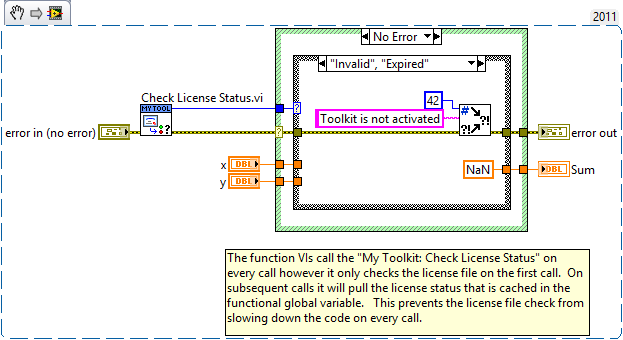

API VIs
Now that you have your core functional global variable created, all you need to do is add this to your API VIs and surround the rest of the code with a case structure.  Then your code will run differently depending on the license status.  The most common situation would be to run normally if the license is in Evaluation or Activated state, and to throw an error if in Expired or Invalid state, but this can be changed based on your licensing scheme.
