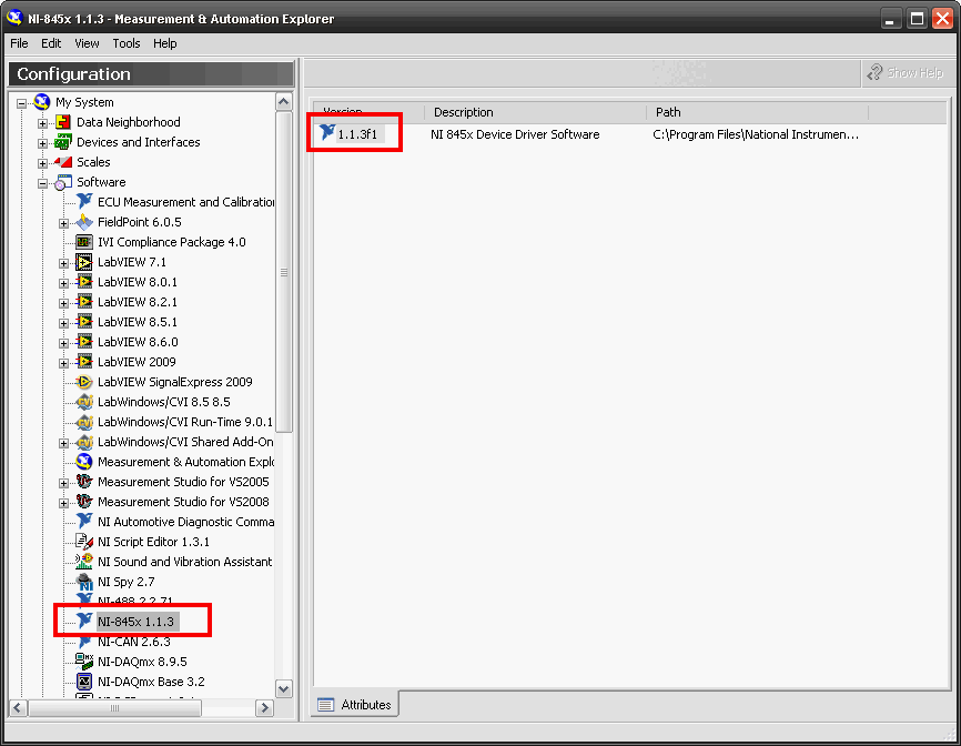

I see that you are getting -301721 errors with your NI USB-8451.  What version of the NI-845x driver and LabVIEW are you using?  You can use Measurement & Automation Explorer (Start»Programs»National Instruments»Measurement & Automation Explorer) to determine this--please note my screen capture for your reference.

I have version 1.1.2f2

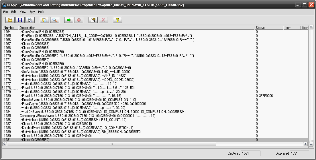

If the issue still persists, please take a NI-Spy capture of your application causing a -301721 error.  I have attached a link to a KnowledgeBase that describes this process.
KnowledgeBase 4P3FR2LQ: Performing a Good NI Spy Capture for Debugging/Troubleshooting

I took the NI-spy files and the .dmp file and put them in a zip file called "blah32 ni8451 requested error files.zip" and uploaded that to the ftp you specified. (I couldn't create a folder with my user name on the ftp, but its the first thing in the file name.)

I have been looking through your files, but I am not able to determine where your 8451 experiences the -301721 error.  Can you refer me to the line number in the NI-Spy capture that shows your 8451 receiving this error?  I am currently looking at the  Capture_NI8451_UNKNOWN_STATUS_CODE_ERROR.spy.

   I don't know where it is either, but the drivers whiel running the program give me the error during that.
I figured out 1 thing I can do to fix it before it does a memory dump of the computer, and afte rit gives me the status code error. IF I unplug the 8451 from the USB connection to the computer then plug it back in, it will work normally again for a while.
I'd still like you guys to look into it, but I gave you a capture from a time when the output to the screen said  -301721 error.
