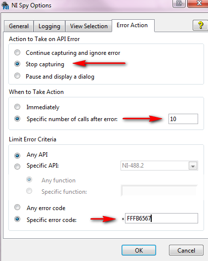

Hello blah32,
Please take a Spy capture again and set it to stop on your error.  Specifically, go to Spy»Options and click on the tab Error Action.  Configure your window to look like the following:
Please post this spy capture once you've got it.  If this only happens occasionally in the shipping example, but very frequently in your code, it sounds like we again have left a connection open to your unit or perhaps you are opening and closing references inside of a loop.  I look forward to this capture so that hopefully we can shed some light on what's happening here. Thanks and have a great day.
