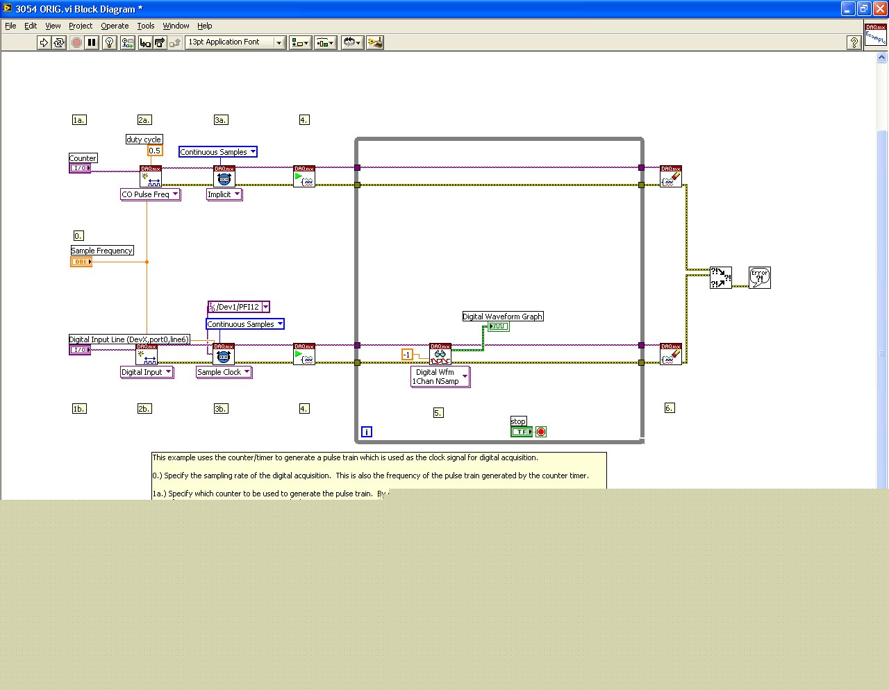

Hi Paolo,
I think that the solution for your problem is to share the clock of your digital channel. I suggest to you to see the screenshot below: remeber to select "Digital output" in the create channel VI and to arrange the entire VI as you like.
Ciao!

Ciao Simone,
thanks a lot for the quick reply and for the example. I started from that and finally managed to have my VI working.
