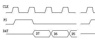

Hi, I have a A/D board which ouput data through a serial interface, the signal timing and format are shown in flowing figure:
CLK is 20MHz data clock, FS is frame start signal (falling edge indicates start of new frame),
each frame contains 8 x 16 bits data for 16 channel A/D.
Is 20MHz CLK too high for 40MHz 7811R FPGA to sample the DAT signal?

我认为可以,你可以考虑使用单tick循环来提高运行精度
