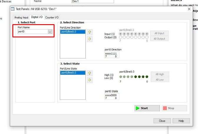

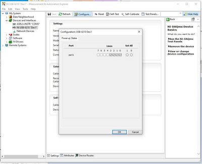

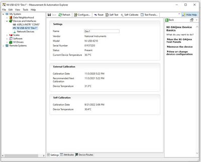

Hi Thanks for your reply. I am going to attach some screen shots. I also realize I mispoke. I am looking at my device under NI-Max. In image 1 we can see my device. In image 2, I am under the configuration tab and can only see port one. In addition, I am unable to select and power-up lines 4-7. In image 3, I can see under test panels that I should be able to change some ports to output ports, which is what I need but I cannot make any changes. Please let me know if there are any additional photos that I can send.

You've to select an appropriate port to see those channels.

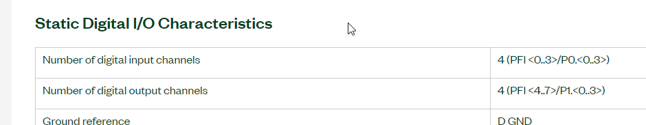

You've Port0 and Port1 for digital lines and P0 is all input and P1 is all output as evident from your device datasheet,
To see the Analog input channels you've to select the appropriate tab,

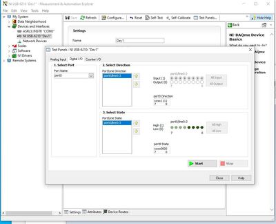

Dear Santhosh,
I am sorry that I am having a difficult time figuring this out. I have attached a photo of what my screen looks like under the port1Test Panels tab (image 1_).  Basically I have a home written Labview program and I need to assign a port to trigger a light source shutter (Image 2_ and 3_). When I assign port that is responsible to trigger the light and where my cable is inserted it does not trigger the light shutter. Right now the wire is in the 7th port under digital I/O which to my understanding should be port 1.1. I am very grateful for your help in resolving this problem.
