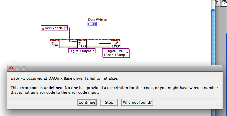

I've been using USB-6501 device on Labview 8.6 on Mac.
The following attached code used to work fine to write data on a port, but for some reason, it's not working the next day.
The error message is also shown in the figure.
Does anyone know a possible cause for this? I ran isdaq and it is still detecting the device as Dev1.
I ran other example VIs for reading and writing DIOs but all gives the same error.
I've tried completely uninstalling the labview and DAQmx base, and re-installed it, but get the same error.
Help urgently needed.

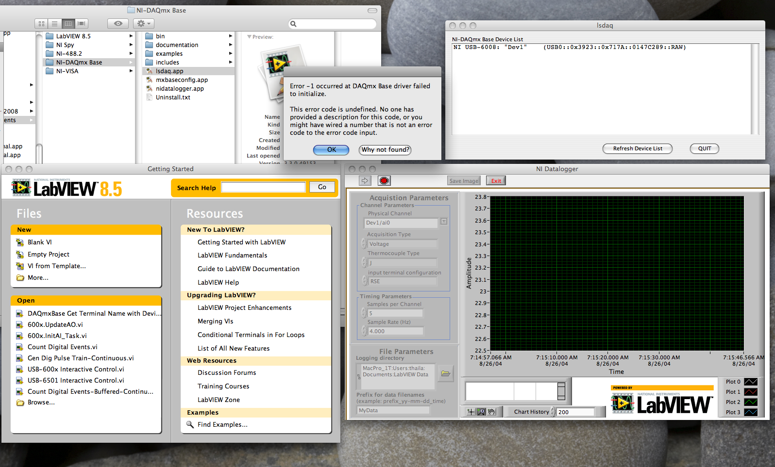

Additional info. I just bought the DAQ USB6008 and connect to a Mac with LV 8.5.1.
1) run the lsdaq, the app detects my 6008
2) run NI Datalogger, get "Error -1 occurred at DAQmx Base driver failed to initialize" NI USB-6008 error.png
