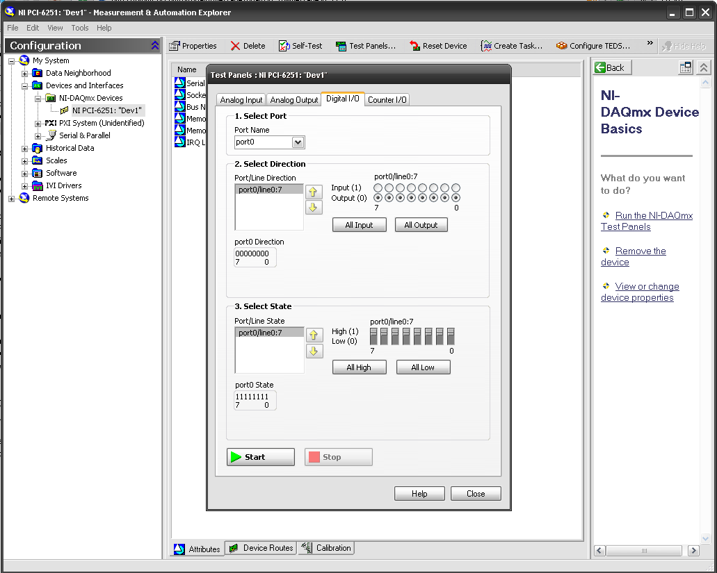

You should be able to output more than 1V as per TTL specs. Have you tested this using Measurement and Automation Explorer's test panel? You will need to configure the digital lines as output lines and set them as high to see 5V as shown in the following picture:
Also, do you see this on all lines on all ports? If this behaviour persists you may have a defective board and you may need to send this in for repair.
Additionally you should be able to use the analog output on your 6229 card to create a signal higher than 1V.
