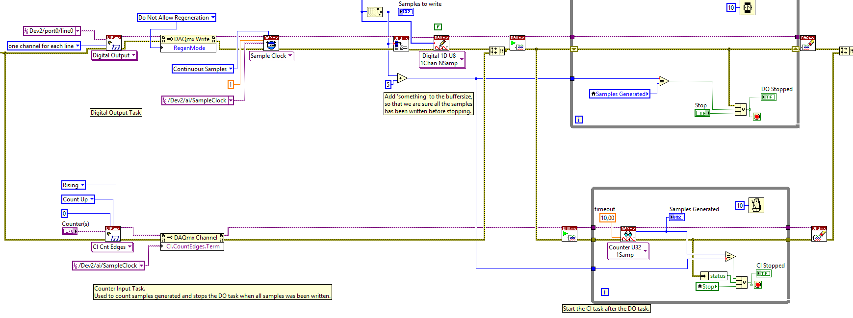

Now, for a "work-around" for your M-series card, you could use a Counter Input task to constantly count the number of ticks from the used sample clock to monitor how many samples have been written. In LabVIEW this could look like this:
If you continuously output digital signals, you will need to make sure that you are keeping track of how many digital values are written to the buffer with each iteration.  It is this value that you will need to compare against the CI-task value to make sure that all of your values have been written out.
I would properly also add some kind of triggering so that the CI task is started at the same time as the DO task. In the example above, I have made sure that my counter does not start before the DO task is started. However, the DO task may generate a couple of samples before the CI task starts, since I have not used a trigger.
It is also worth paying attention to how many samples you plan on sending out during the execution of the code.  M Series cards have 32-bit counters which can only count up to 4294967296 before they roll over and start counting up from 0 again.  If the code is going to be executing at fast sampling rates or for long periods of time, you may need to also write some code to make sure you handle this correct.
