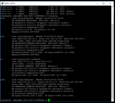

ok i have this crio connected on USB AN ETH, i can ping I can connect
on ni max say
software on the PC is
and the image is the same 2018
radutility goes
Model Model Code Serial Number MAC Address IP Address Host Name App Image Name App Image Version Time Result
cRIO-9057 79E0 023FF4AD 00:80:2F:41:7A:64 192.168.33.3 NI-cRIO-9057-023FF4AD CR304_ 4.5.0 0% Error -2147220354 at nisyscfg.lvlib:Restart.vi:1680001<APPEND>

firewall is
setting on crio are
what to do?
there is no way to make it work

I set the IP address in static, the only other possibility is local only, but it is realtime...
i'll try that.
but it is stupid
(262 Views)
nope, it did not help
i am now on SERIAL connection
no reason for me to get any comunication problem, an so, still there no programming and  Inconsistend IP setting
