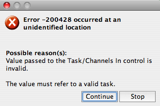

Thanks for your help. However, I'm still not getting this to work. As you said, I typed in Dev1 / Port0 to create channel, but it still gives error as shown in this picture.

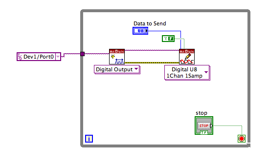

My VI looks like this.
Could you help me again what I'm doing wrong?

Hello Keong,
You will want to first move your Create Channel VI outside of your while loop (you do not want to create a channel every loop iteration).  Also, make sure you are referencing port0 not Port0. And I'm not sure how Macs handle slashes, but you may try a backslash '\' instead of a front slash.  Finally, you are just outputting a single value, but you are referencing a port.  Make sure you reference a specific line.

Anyhow, I am still getting the same error, saying that Value passed to the Task/Channels In control is invalid.

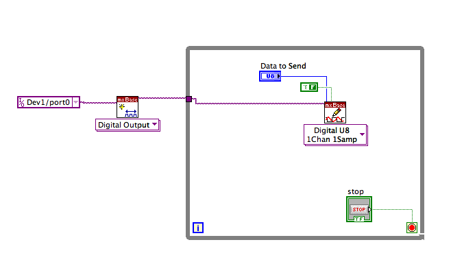

Here's my VI:
Please help me again,
Keong

Keong,
I am not sure what causes this, but place a create task VI before your code and wire the task output to the task input on the create channel and try running that.  Please let me know if this works for you.

Hi Cole,
This worked. I guess you have to make a task first before you make a channel.

Keong,
I looked into this more and since DAQmx Base is all VISA based communication, DAQmx Base does not dynamically create tasks like DAQmx will.  Any task will always need to specifically be created before trying to create a channel.
