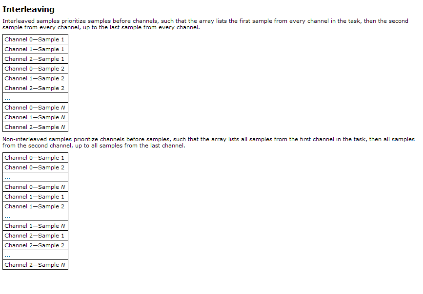

The format of the data returned by this function is a 1D array that depends on fillMode input:

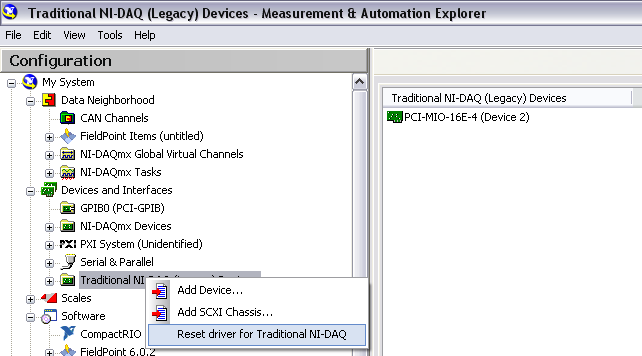

One problem is that AFTER one time through all this code, each further iteration gives the error code -200587 for DAQmxStartTask AND DAQmxReadDigitalLines.  The rest continue to return 0.  This error code means, from my understanding that the digital lines are reserved.  I'm not understanding though why StopTask and ClearTask aren't taking care of this error.

The error you are receiving (-200587) does indicate that a resource is reserved.  This could likely be caused by Traditional DAQ, which does not release control of a DAQ Device until it is Reset.  So, if switching from Traditional DAQ to DAQmx, you would need to reset the Traditional DAQ Driver.  You can do this in Measurement and Automation Explorer by right-clicking on the Traditional NI-DAQ category as seen below:
