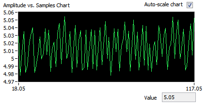

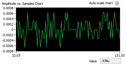

Here are the results from my 6353 running a loopback from DO to AI (at High and Low)
21425i014F72FAC445037721427i368E34220A9A222A
So, at High logic levels I am seeing noise on the order of what you described.  At low logic levels my noise is significantly less.  I suppose it really depends on how noisy your ground plane is and what else the board is doing, as well as what is connected to it.
     *Edit, I suppose a more legitimate test would be to use a 2nd board to measure the voltage output.  I still think this test has some merit in showing that some noise on the DO line is not uncommon.
In any case, since the lines are Digital Outputs, the spec just states that they must meet TTL voltage levels (< .4V for a logic low, >2.4V for logic high).  I don't have any typical numbers for noise on the lines, but what you're seeing does not seem unreasonable.  Have you tried adding bypass capacitors at your relays by any chance?
