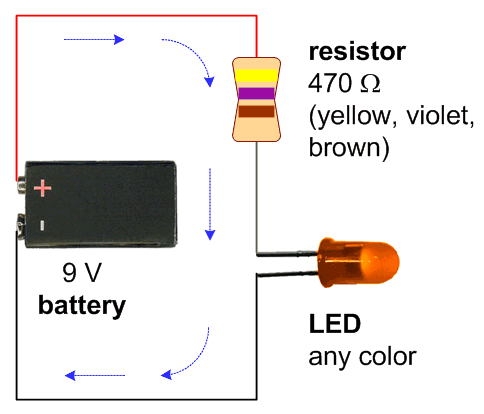

      Victor's solution is better than what I was going to propse so I wont bother 😉  I do, however, recommend you take a voltmeter to your LEDs with respect to GND and figure out what voltage is driving them.  It looks like the 6509 reads high at 2V and low at 0.8V.  Depending on how the LED circuit was designed, this may (likely) or may not be enough.
LED circuit image stolen from robotroom.com:
In your case, your computer is supplying the power to the LED, and it could be from the 3.3, 5 or 12 volt rail.  The resistor may be before or after the LED.  Additionally, they could be doing something more exotic that doesn't involve a resistor (like a current controlled LED driver) but that's less likely than a simple resistor-LED combination.
The voltage drop across the LED depends on the color, but is generally around 0.9 - 1.4V.  This *could* be a problem, but it's entirely likely that the source of the LED voltage is just a 5V signal and you might get to measure the voltage before the resistor.
So the answer is... "it depends" 😉   Grab a cheapie multimeter and probe around... and tell us what you find!  It's very likely that a few PCI-6509s sitting in a computer (or alternatively, some USB-6509s) will do the trick.  Even if the voltage isn't within the range of the 6509 there are many many solutions to your app, but none of them cheaper 😉
