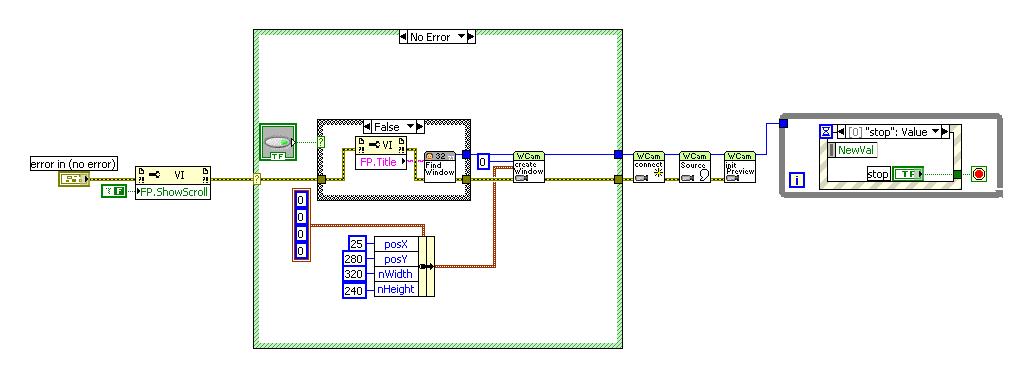

I found a tutorial in a .pdf about usb webcams and how to make them work with labview...so...I managed to do this following diagram!
But it still doesn't work...what am I doing wrong? Or...do you have a better diagram for this application? Or a mors simple diagram!

it creates an additional window that is all black... so I have 2 windows one of them displays the image of the webcam and the onter it just...stays black...and I can't get rid of it...I tryied deleting some blocks but...!
That's why I was wondering if there was a simpler diagram for what I need... just an image from a webcam! continuous filming...

Hi snuk,
if you need only one window, then delete the second "create Window" function.
See the attached picture for more information.
Mike

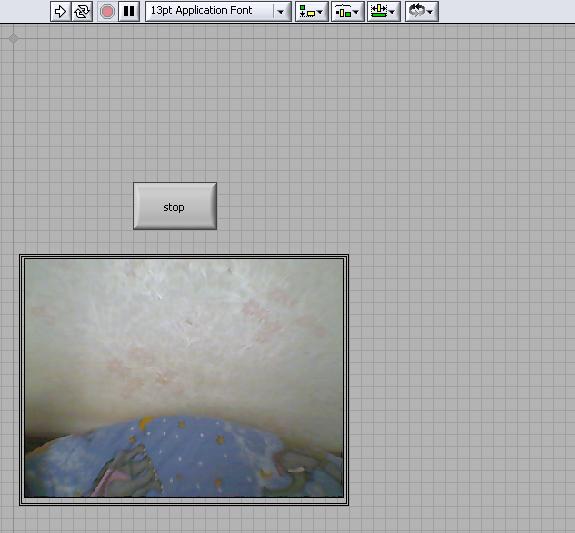

So...I've deleted the blocks and it looks like this
and the front panel

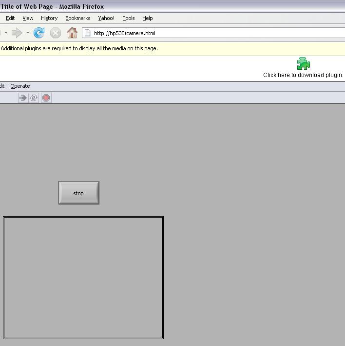

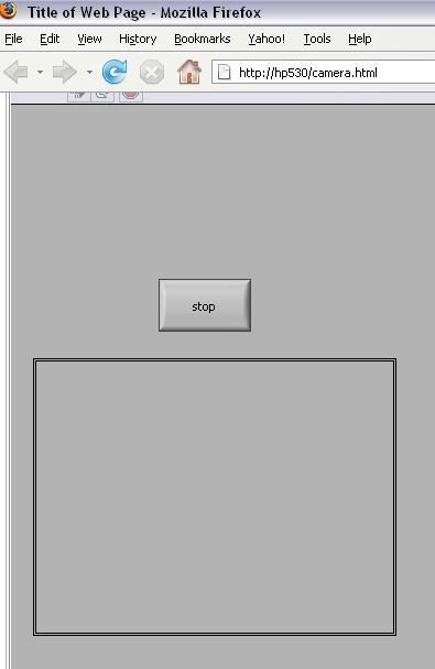

Now...I wanna publish it on a webpage...and when I acces it with my browser it shows this

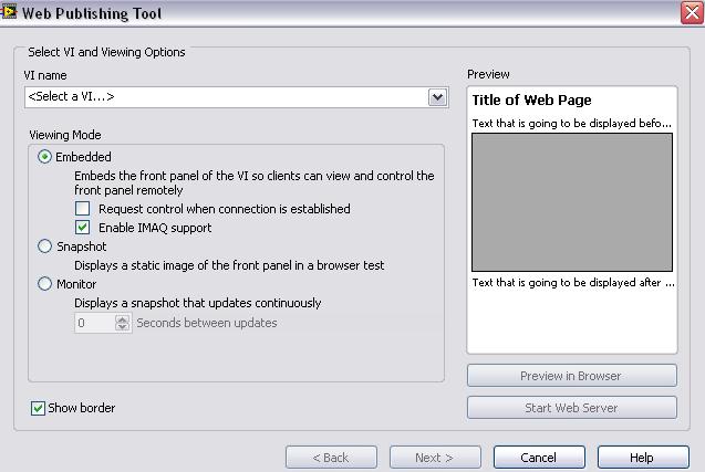

After that i tryied doin this to the web publish tool...inserting the imaq option...and now it sayis to download the IMAQ 8.5...altough I have imaq 8.6 installed!!!! :-s

Hi snuk,
the vi's you use have nothing to do with IMAQ. The reason why you don't see the webcam image in your browser is, that it is not really a part of the vi. It's only drawn on the front panel.
You can try it with a .Net PictureBox. Get the handle from it with a property node and type cast it to I32. Use this handle instead of the handle from the "create Window" function.
Mike
