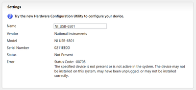

I just getting started with my new NI USB-6501 device.
In the MAX tool, the device is visible but it reports error Status Code: -88705.
In the Device Manager, it's visible as a USB Firmware Loader.
Does anybody know what's going on here?

Hi Mun,
Please have a look at the link below and try the steps to see if the issue has been resolved.
DAQ Device Shows up as USB Flash Firmware Loader in Device Manager
(2,533 Views)
It's resolved! I think it was the company's overeager security software.
I asked a colleague to also have a try. After installing DAQExpress it worked right away. Then it also worked on my system.
